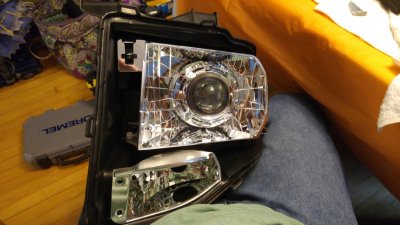

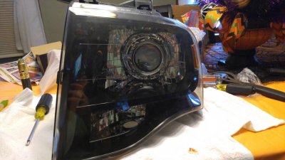

Retrofit looks great. Do you remember what brand? Any issues with non-DOT lights (tickets)?
These are Morimoto Mini H1 7.0. They can be found at theretrofitsource.com or Lightwerkz.net
I'm From Massachusetts and we have a pretty strict vehicle inspection and I've passed 3 years with the projectors. No tickets, not blinding people. Everyone just assumes its the oem headlights.
