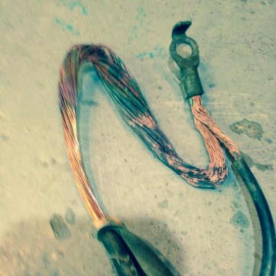

I followed your instructions, discovered bad or questionable "cooked" grounds, main to starter and loose and cooked frame ground. I meticulously cleaned and repaired all the grounds and also the power connections at the starter and of course battery and applied dielectric grease to all those connections.
