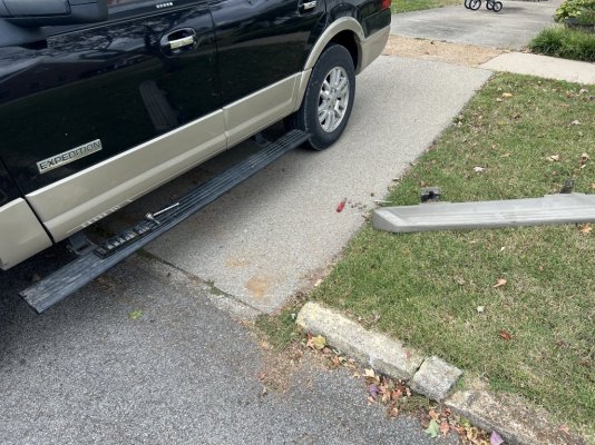

I am surprised to hear of all the problems, I but my Expy new in 2007 with the retracting running boards, the car has spent 4 years in wet Seattle weather (parked outside) and the rest of the time in Texas (also parked outside) and I have never had any problems, they still work as well today as they did when I first bought the car, i have never done anything to them, I like the tidy appearance that they give the car, Not sure I would spend money to get them fitted after market, but really like that they came with the car.. Car has done just over 140K miles..

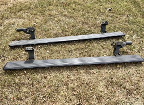

I would be concerned by the amount of additional wiring that needs to be added. Having said in 10 years I have never had a problem, this weekend the drivers side packed up. I purchased a replacement motor unit form eBay ($70) and installed it, very easy to do and $70 seemed a good price to me, but I noticed there are 5 wires going to each motor unit, so you need to run 10 additional wires (5 to each side of the car) if you fit aftermarket units!! I assume the ford wiring is not present if you didn't have the retracting running boards from new. The eBay motor unit is a lot lighter than the original ford motor unit, but my Expedition is a 2008 model, so Ford may have made the units much lighter in the last 10 years, but the new units are so much quieter than my old units!! I am thinking about changing the passenger side motor unit just because the motors are so much quieter (The passenger side has seen far less use than the drivers side and works perfectly, just the motor unit is mechanically noisy!) but I hate to change something when it still works fine.

Yes, wiring won't be fun but it's not terrible, either, as evidenced by some installation videos that are available on YouTube. Assuming you install the same quality parts, the only difference between an aftermarket retrofit and getting a truck with OEM units would be the integration of the controls into the vehicle computer network. You would lose things like settings in the instrument cluster (auto vs off). The AMP units come with a module to control them that taps into the Body Control Module (SJB) behind the right kick panel.
