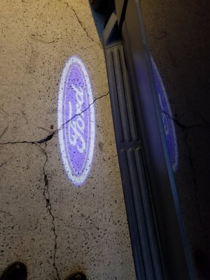

2016 OEM puddle lights for sale in classifieds. If you want a second set to mess around and convert to led
