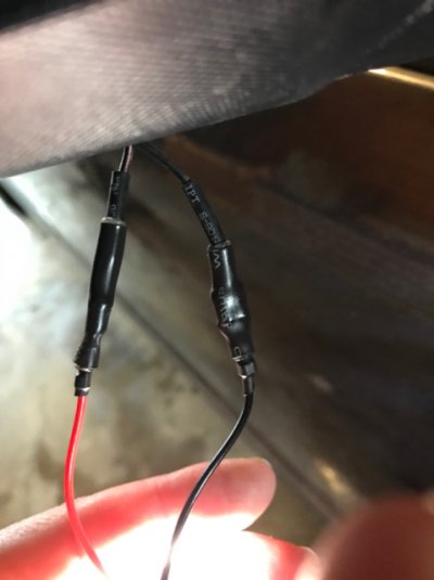

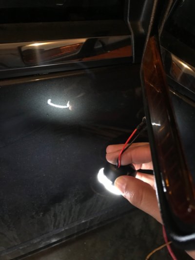

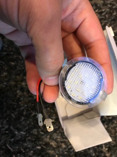

Took me all of 5 minutes to install. Flat head screwdriver to depress the tab on OEM and gently pry outward on housing, DC the two connections, pop the new one back in. Here’s what the connectors on the new ones look like View attachment 22718

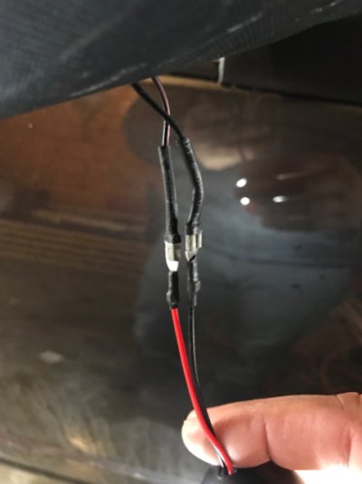

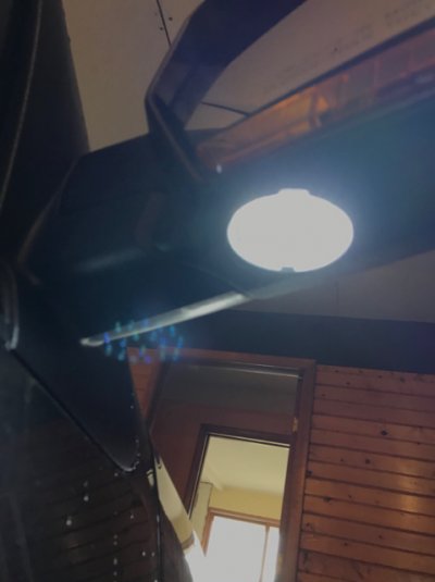

They just slide right on. I wrapped some electrical tape around them as well. And that push tab on the new ones is a lot more sturdy than the old OEM one. I would definitely switch to LED interior ($12 on amazon for a decent set) I did not like the look of puddle lights as halogen with all my other lights LED as shown below:
Much cleaner look with interior LEDs and these new puddle lights
Cool, thanks for the pics because i agree after seeing how they conflict i should buy the interiors as well to make them all white.
