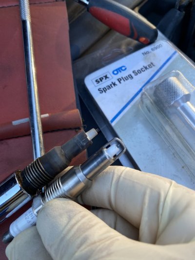

f150dave2002
Sep 27, 2011
44
Aptos, California
Spark plugs… sometimes one lasts 8,000 miles and some go 80,000+… with the platinum plugs, replace around 30,000 miles for best performance and be sure to stick with motorcraft plugs… IMG_2209.jpeg
