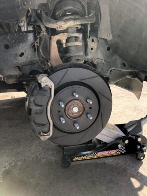

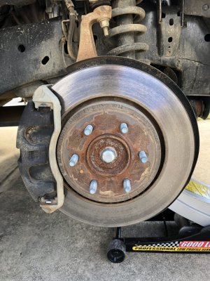

44E47A49-3B22-47B9-9952-DC138030471D.jpeg 8D870E8A-8171-430D-B3D6-63BF86729D78.jpeg Took forever, but I got them installed finally and put some miles on them, about 1K so far.
Bottom-line is that they are an improvement over the stock brakes in every way except one: initial cold bite. The first stop after they’ve been sitting cold lacks grab, but once they warm up, they are fantastic. Grab is linear and easy to modulate, braking from high speeds is much stronger and doesn’t require as much pedal force as it did before. Granted, my stock pads were shot, as evidenced by the pictures, but still a noteworthy improvement.
Fade is also decreased versus the old stuff. Driving the downhill 12 miles home from work would easily cook the stock brakes, and these don’t seem to suffer any fade at all.
The improved looks are just a side benefit, and they do look way better under the wheels.
For $200 shipped to my door for the fronts, I’d say they were a good choice. I’ll keep this updated as the miles continue to increase.

It looks like that rotor is installed on the wrong side.
The slots will tend to drive debris and water toward the center. Not good.

I actually discussed this with R1, and while they recommend the other direction typically, they also said it comes down to user preference. In my case, even with angled vents (which this rotor does not have) I would run my rotors this direction.
I’ve never seen hard evidence of any detrimental effects due to them being run this direction, but I don’t know everything, and if there’s something I’m missing please let me know where I can find the information so I’m aware for the future

I suppose if the internal cooling vanes are radial and not directional (angled), then the configuration of the surface slots is not super important, especially if they do not continue through to the rotor edge.
Why do you run them against recommended direction? Are they more quiet that way?

They aren’t more quiet, it stems from my track days, when running angled/curved vanes this direction as opposed to normal, it forces more air into the center of the rotor. A 3,700-pound car riding on 11-inch twin-piston brakes needed all the help I could give it in the cooling department.
