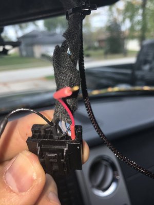

MIRRORTAP POWER CORDS MirrorTap... https://www.amazon.com/dp/B01LBKR2SA?ref=ppx_pop_mob_ap_share
I got this to tap the auto-dim mirror. I have a cobra iRadar detector mounted there. I’ll take a picture of the tap points when I’m at the truck next, but I think I found the correct wires first or second try with a multimeter; you want to find the pins that turn off when the car is off so the detector doesn’t kill the battery.
