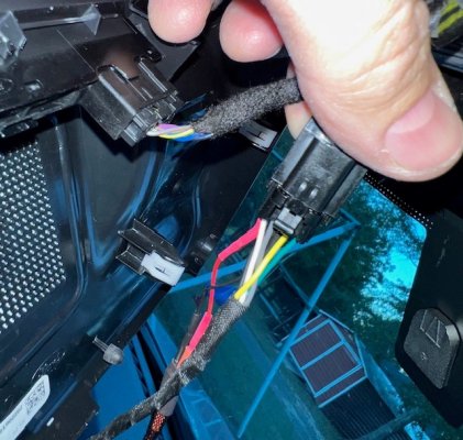

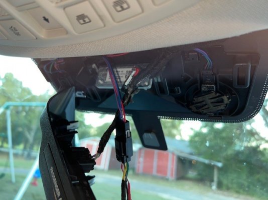

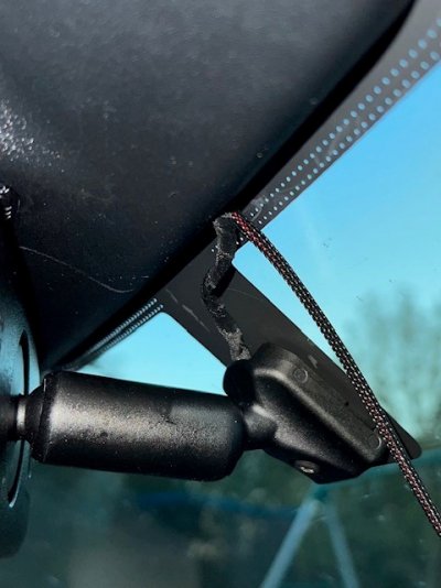

Reviving an old thread - I can't answer Spencer's question, but I can update the install for '22's.
Installed a Uniden R8 on a Blendmount using Mirror Taps yesterday evening. The clip location and design appears to have changed slightly, but I can confirm it is still the white (+) and black (-) wires on the mirror side of the plug that can be tapped for switched power.
Thanks to Bow512 and the others in this thread. Very helpful, and hopefully these photos might provide additional assistance to others in the future.

Thanks chaffdb, I was hoping this thread might lead to a '22 discussion!

Thanks for the thread everyone, very helpful.
I spliced a dashcam charger and a radar telephone cable together into one set of red and black wires and tapped into the mirror switch as above. Both worked without issues on a 13h road trip.
Want to add that there’s enough space in the headliner area to stash away the 5V dashcam box and a bunch of excess wire cleanly, all covered by the plastic trim piece.

Thanks chaffdb. I found this thread via G**gle search and was able to get my V1 radar detector working in my 2024 Expedition Timberline.

No need to splice they sell a splitter that just pops in. Easy peasy.
Hello Legal - I just bought a new 2024 Expedition XLT, but have not taken delivery of it yet. I plan to transfer my Valentine One Gen 2 Radar Detector from my 2003 to my 2024. I used a MirrorTap to power it on my 2003 but am always interested in how to do it easier. Is the spiltter you mention the MirrorTap-type that Chaffdb documented, or a another product?
Thanks for any info you can provide. I need to puzzle this out because I have grown so accustomed to my V1 G2 that I find it hard to drive without it!

Thank you for the pictures!!!
I unplugged the mirror whip and then put black into black and red into light grey, and then I connected the whip back into where it was.
