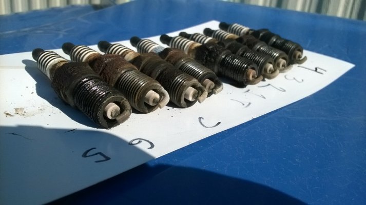

Findings: I put a new set of autolite platnum plugs and autolite wires in 15k miles and 11 month ago the plugs claimed to be gapped correctly when I bought them but found them to be at .051 when I checked after removal. my motorcraft ones are at .054.
the wires looked okay except for two of them. the inside of the plug connector was corroded, likely from forgetting to use dielectric grease.
the plugs looked okay-ish just looks like I need a new set of valve seals or a new engine, depending on where the oil is coming from. the plugs in the picture below are arranged 5-6-7-8 1-2-3-4. I am not all that great yet when it comes looking at a plug and knowing how it's burning. this is only the third time I have pulled a set of plugs, please let me know if something needs to be addressed
