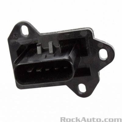

There's a speed control resistor back there in the box by the motor too. They burn out just like the fronts do. See if you're getting voltage at the resistor. Then the motor.
Rear Speed Control Resistor at Rock Auto
