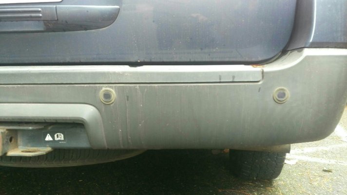

I was thinking about installing recessed LED lights into my rear bumper. I have a driveway that has turns and is uphill. Before I buy them, is this possible? I felt around in there, felt like it might be all a metal beam behind the plastic bumper cover. Thinking about between the two sensors: 850ff2ffaf4891622a9484c268e1709e.jpg

Anything is possible...flush mount?
Mr. 10K
Yep, flush mount. .. just wondering if that steel beam has any gaps. Or if I have to hack in to it. I don't want to buy the lights, and find out for some reason it won't work.

Well yes, however I can't see a whole lot and would need to take the plastic bumper off to get an accurate look... I ask because someone may gave already taken the plunge...

There are no tabs on the beam but if you're handy with a tape measure and a drill it's possible. It's a lot of work trying to line up the holes on the bumper cover to the new tabs added a good idea would be to use a hot center punch or nail and pushing it through the back of the beam to the bumper cover creating a dimple indicating where the new tabs are located precisely then comes the issue with finding a way to mount the new lights flush while maintaining a "clean factory look" after all that is said and done you'll have to remove the bumper again and wire up the new lights and I'm assuming you'll want to tap into the reverse lights on this one, also finding a powerful enough to be useful led bulb is a challenge of its own. There's far more work between those steps but those are the biggest obstacles you have to overcome.

Behind the rear bumper cover is a solid foam impact absorber. Go to ford parts com and enter your information look under BODY then BUMPER it will show all the parts so you get a better idea of what your going to be up against

My plan was to use a wiring harness with a relay, that way they are switched on with the reverse light, but don't depend on that circuit for its power.
Perfect, exactly what I was looking for. Thanks!

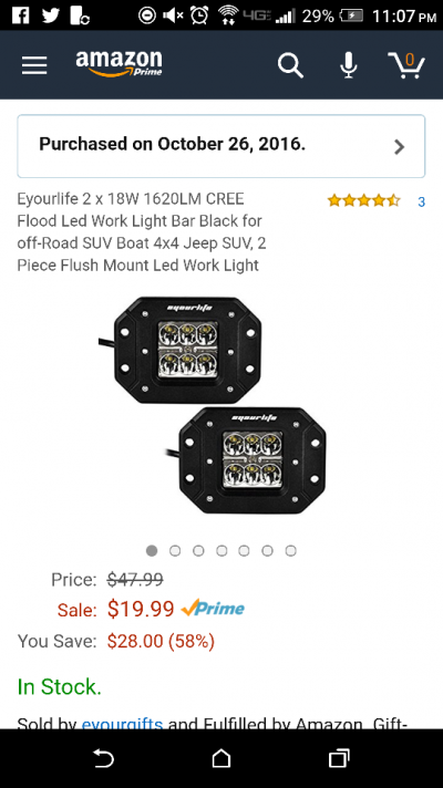

These are arriving tomorrow. I'll post pictures when I'm finished.

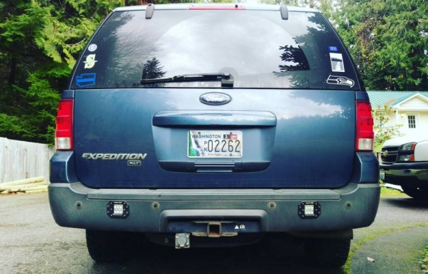

Well, I only had a little time to work on it before it got dark. I opted to mount them in between the backup sensors. I didn't account for the upward bend of the hitch, which barely hits the light. So I ground some of the aluminum case on the light. It's not bolted in yet, but it looks good!6d85014472dfe58beeade3c98e422c13.jpgbf72deac1bf588b898b356e0155e32ee.jpg

Update: both sides are bolted in. I ended up dropping the hitch to access the back side of the bumper to tighten the bolts. Next week I'll wire it up. f6b6175cd3543dfb19df7ad13cb56217.jpg

I finally had some time to wire them in. WOW! I'm impressed... IMG_20161206_191332.jpg
