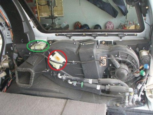

Do you notice a difference in rear air temperature if you move the rear air control panel temp selector from cold to hot and back ? Just wondering if your rear air temperature door actuator took a ****. It's a common failure item.
Red circled actuator is temperature select .... Green is vent control top or bottom ....

Yea I'm thinking you are correct, also making annoying clicking noise... ordered from Amazon, $53.You're a rockstar, thanks again!
