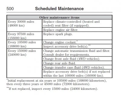

Where does it say that?
My 2014 owners manual says change every 150000 miles
.. but they call it "rear axle fluid" so is that the diff?
(I'm gonna do all 4 at 110,000)
and WTH is an accessory drive belt(s) ... serpentine?
Page 500 of my 2014 manual says the same thing. However, on page 340 it says "Your vehicle's rear axle is filled with a synthetic rear axle lubricant and is considered lubricated for life. These lubricants are not to be checked or changed unless a leak is suspected, service is required, or the axle has been submerged in water."
I think I found where I messed up...unless service is required...I missed that. So, service is required on the rear diff at 150,000 miles, which I guess is Ford's definition of "life.". So, when it gets to 150,000 I'll change it. Thanks for motivating me to go back into the manual and take a look.
