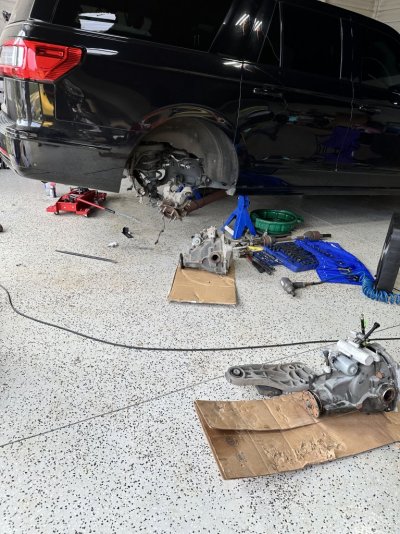

Just an update, I ended up purchasing a salvage one to swap in and keep my truck on the road. So far no noise, I did notice the HCU on top has been updated to a newer style. I plan on opening up my differential this week to see what’s damaged and if I can get away with just replacing the actuator.IMG_3462.jpeg

My 2019 makes a grind occasionally when I turn backing up. But it never does it if I turn off traction control. So there may be a connection there to my noise.

Hopefully it’s just a traction issue! The differential issue for me was in both directions when turning. I’m guessing I had the problem for a long time now because it feels like a different truck now that it’s so quiet.

Just an update, I ended up purchasing a salvage one to swap in and keep my truck on the road. So far no noise, I did notice the HCU on top has been updated to a newer style. I plan on opening up my differential this week to see what’s damaged and if I can get away with just replacing the actuator.View attachment 82216
Hey, since you can see things better, is it possible to change the hydraulic pump oil with the diff in the car??
