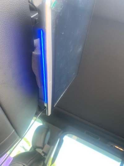

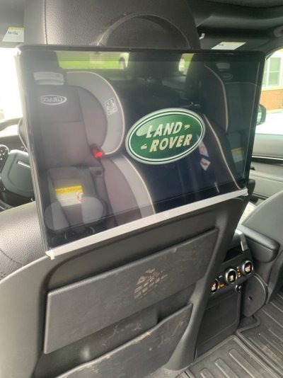

The aftermarket set up is much better. I have WiFi TVs in mine and they have been great so far. They were 1/4 the price of factory and came with BT headphones and headrest mounts.
