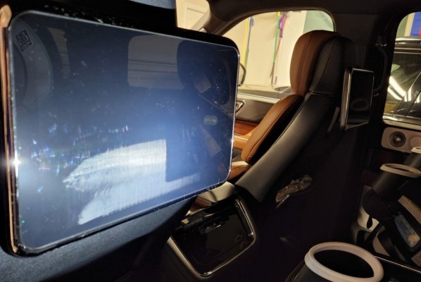

just joined the club of failed RES. Friday set it up for a trip with bluetooth connection to the cars audio from each screen. That worked. Also successfully mirrored an android device to the left screen with audio through the sound system - was very muddy and low quality but worked. While watching you tube for less than 5 minutes after I thought everything was done, the left screen failed. You have background light and it is warm but nothing happens. No touch buttons including power or any images whatsoever come up on the screen. use of the remote also does not power on or off the system. Less than 10 minutes after the left screen developed a fault, with me still seated on the middle bench wondering what was happening, the images on the right which had been independent of the left mirrored to the android, also failed. Now both have a light glow to them when the car is powered on and this remains on even with the car powered off. I have checked over 15 minutes after turning the car off in the garage and the screens still have the background light on. Will check again a few hours later, but this has the potential to become an energy drain issue if it remains on overnight - I did not check Saturday or Sunday morning upon getting to the car as I assumed it would shut down. Will update entry in a couple of hours or tomorrow
