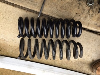

Bob what springs are those on your front end ? They look like the KYB springs I just took off. With the weight of the vehicle on the ground I only had about 1" of available compression travel before the springs were binding and bottomed out. There are so many coils there it had no room to compress. I went and got some Monroe Quick Struts for now. Much better ride. More like the stock new ride.
Monroes on the left, KYB on the right ....
A way to check is you shouldn't be able to see the spring perch extending below your shock. It should be tucked inside the bottom of the spring like in this picture.
