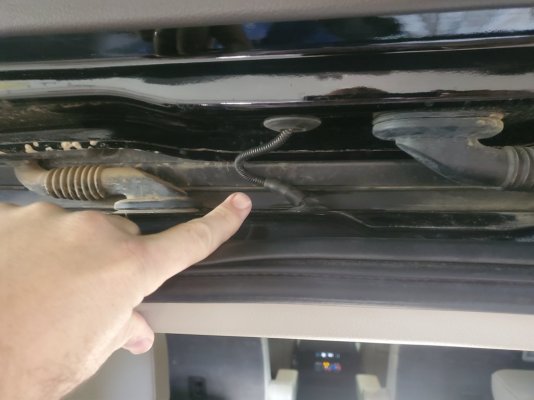

Rear washer fluid nozzle just spitting a little fluid, no useful spray. 2018 Ford Expedition Max Limited
briaboc
Nov 16, 2021
Chaska, MN
If anyone has had this issue, please let me know if there is a good place to start my troubleshooting. Thanks in advance!

Is the rear camera washer working? If not, that could at least tell you the issue is between the reservoir and the rear of the vehicle. If the camera washer is working, that narrows down your search a bit as the fluid is at least making it back there.
