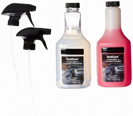

WeatherTech makes a dressing for their floor liners that keeps them from becoming slippery. Perhaps something like that would work. https://www.amazon.com/WeatherTech-...516820437&sr=1-1&keywords=weathertech+cleaner

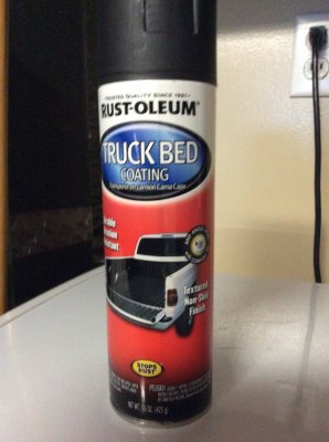

I coated mine with flat black Rusoleum Bed Liner (spray can version) after a wash down with acetone. Available at Lowe’s and WalMart. Mine were not the folding style but this should work. It gives a nice nonslip texture and still looks like new after a year of use and many power washes. Use one can for each running board, 1/2 can for rear bumper step and I even removed my cowl grill and spayed that. It all looks great! Be sure to cover the surrounding areas (driveway and body paint) by at least 2 to 3 feet as the spray gets out of control at times.
Whaaaaat??
Rusto Liner is just heavier duty plastidip, how on earth did that hold up to people scraping boots over it???
Some i sprayed in my wheel liners peeled up after driving thru semi-flooded areas in a tropical storm...
Or did you use an older formula that's different???

I used this also on my folding running boards after careful preparation, and it has held up reasonably well (about 2 years now), however, there is about a 3" circle worn off where I step each time. It will need done again this summer I think, and I'll look for something different to use this time. I had no prior experience with this stuff when I did it, and wish I'd found something else.

Good to know. I haven’t gotten to this project yet
