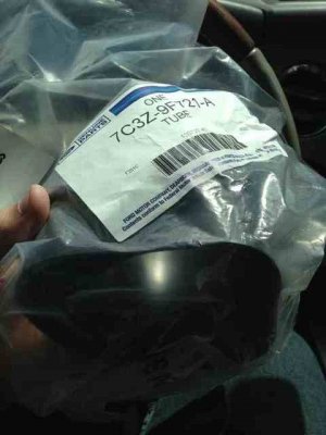

I've been searching and searching and haven't been able to find a how-to on removing the whole of the airbox. I purchased the larger 3" snorkel tube from ford and want to replace the more restrictive 2" tube.

Should just be a couple of 13 mm bolts. The hardest part is seating the snorkel in the box.

I've got a k&n drop in with the larger tube. So far I haven't noticed a ton as far as performance goes. Maybe a bit more responsive. Gas mileage is a different story. Easily 2 mpg better after the battery disconnect. I'm actually shocked. I'll report back again when I have some more hard evidence. I keep track of every fill up.
No tune at all. Maybe next tax season. All depends how it tows the camper at 60 mph on the hills.
