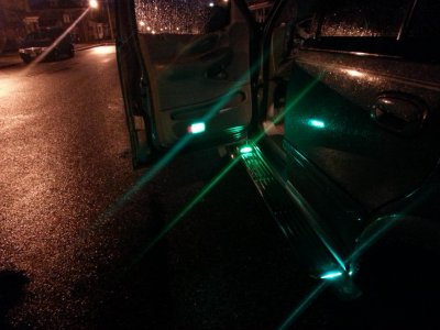

Finally
...the weather cooperated & i was able to tackle my Driver's side courtesy door light issue. after about 30 min & a pair of small flat nose pliers i was able to get the get to the bulb & socket, swapped out the old bulb for the new LED bulb. here's the final product.
