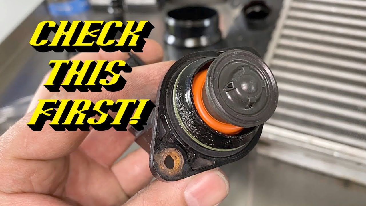

The PO299 Code could possibly be
Air Filter - probably not but cheap to try.
One of the wastegates.
Turbo bypass solenoid.
Turbo blowoff valve.
Leak in any of the turbo high pressure plumbing from either turbo through the intercooler and to the engine throttle body.
With regard to the oil change, that is an indication of the ripoff being attempted. We usually do our own maintenance, but sometimes have our dealer change the oil when we are in FL. A full synthetic oil change with filter is approximately $115 - $125. Last time we did this at dealer was 12/24, so price may have changed some, but not tripled.
Maybe other members on here can suggest an honest repair shop or dealer that they have had good experiences with in your specific area.
Here is a decent diag process for the PO299 code. Done on F150 but same 3.5 T/T. Start at 1:30
