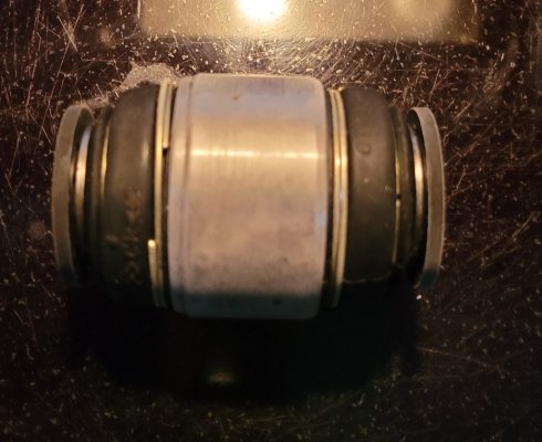

Working on new to me 2006 Lincoln Navigator Ultimate 4wd w/air suspension. Have all the parts to rebuild front lower control arms and have removed old ball joints and bushings from arms using long threaded 5/8” rods and ball joint press receiving cups. I own a real press but the arms will not fit in it.
Can’t figure out what tool (adapter?) to use to press in the bushings. My normal sleeves will not fit over top of bushing because of the rubber bumpers shown in picts. Am a mechanic and have done tons of bushings before with no problems but this one has me scratching my head, any suggestions would be much appreciated!
Tried one and damaged the bushing...arrrrgggg

No worries about it being a Navi, same thing basically. I gave up on my quest when I decided I had to make a tool to fit between the rubber stubs on the bushings. I couldn't find a single shop willing to even try pressing them in, their fear was the aluminum cracking. I ended up buying replacement arms, TRM brand. I still have new bushings on the shelf as a result. Sorry I don't have better news, maybe someone else here will come along with something miraculous.

Yes, that was the conclusion I came to, tool would have to fit between bumpers to put force on correct area not to distort the bushing like I did.
If I owned a machine shop I’m sure I could fabricate something to do the job but not worth the effort at this point. I even called Moog and they were less than helpful. Too bad their replacement arms are the cruddy RK stuff that wears out quick.
