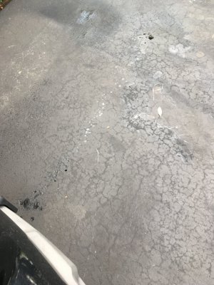

OK ... this is really humorous. I just went out to drive my 2003 to The Depot. Brake pedal goes right to the floor. Pump it couple times, same. Put in reverse ... NO BRAKES or very little. I was able to stop it, just barely after a few feet. Crap on driveway!!! Gotta be brake fluid I would guess. No brakes.
I can drive my 2014EL until I get the 2003 repaired. I'm gonna take the attitude that you helped me out by precipitating a failure in a safe location (driveway) rather than out in traffic where it would SUCK. TFF
:33:
Once I look at it, I'll post up what broke

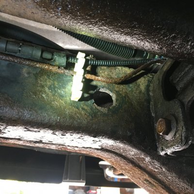

......Once I look at it, I'll post up what broke
Yes my superhuman leg strength blew out the 99% corroded front passenger steel brake line. I had already replaced the 2 steel lines to the rear so now I will do the 2 to the front. Need to do a couple other things at this time so a few jobs to do on the BEAST to keep it on life support. The flexible line on the driver side is original so I will do that at the same time since wrenching it is sketchy with all the corrosion. I hate corrosion. I could probably skip the driver side steel and flexible lines ... but thats like driving past a rest stop on I80 about an hour after a large coffee.
