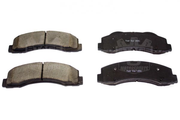

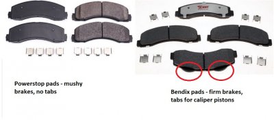

Thanks for checking! The spongy, sinking pedal is definitely a new characteristic since I changed out the brakes. I'm just saying I can get enough pressure to stop the truck. The initial bite is pretty high in the pedal travel but it takes a significant amount of additional travel to increase braking force.
I checked in my other vehicle (Subaru WRX STI) and it stays firm no matter how much pressure I apply. My wife's Odyssey, however, goes to the floor fairly easily. To be fair, it needs front brakes soon.
EDIT: Also, I should add that I never get firm pressure on the first push. It goes right to the floor unless I pump it 3-4 times.
