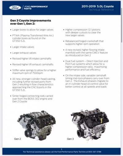

I would not say that expectation is correct out of new buyers globally. Many plan to and should get long vehicle life with good maintenance, freak accidents happen as do mistakes though. I hope to get 200-250k out of my 2023 F-150 5.0L V8. Can’t speak on the EcoBoost as I’m not as well educated on it like others here are. Coming from a 5.4L 3V Expedition and comparing to the 5.0L 4V engine in the F-150 it would appear from an engineering standpoint that the 5.0 is built much beefier than the 5.4 was. The 3rd & 4th gen 5.0 have the forged steel crankshaft and sinter forged connecting rods out of the OG 2012 Boss 302 Road-Runner motor stock off the showroom floor since 2018. All that good stuff was just cast and powdered metal on the 5.4 Triton.
