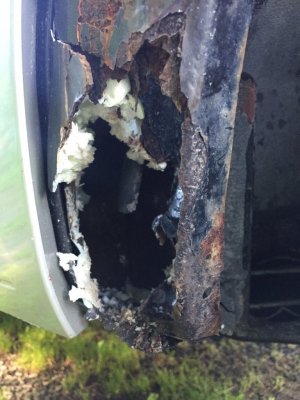

Ford has drain tubes running INTO the rockers from the rear opening windows and the sunroof. They rot from the inside out, as if it was planned (totally was). Before putting new rockers on, you'll want to extend those drain tubes so they drain the water to the ground instead of into the rocker. I know this because I'm dealing with this now. The tubes are at the front and rear of the rocker, ensuring that the cab corners also get wet, causing those to rust out too. You can see the rear tube location in the photo I attached. Yes there's foam in there from a shady dealer covering it all up.

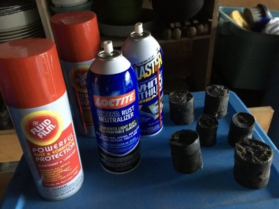

There are large holes all along the inside of the rocker panels that let salt brine from the road inside where it is quite destructive. IMHO this is far worse than the drain tubes mentioned. The drain tubes might actually be productive to rinse the salt brine out? Of course this is just an opinion, I dunno for sure.
Every spring I flush my rocker panels out using those big holes, then (after fully dry) I have it Krown treated. In the fall I spray more goobus in there and install custom plugs in those holes to keep the salt brine out for winter. Working good so far. I think there is minimal to no rust inside the rocker panels of my 2014EL.
