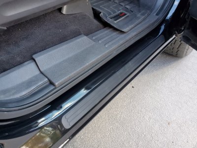

Yes the 2006 model year rocker panels fit perfectly with a little finagling. I’m not sure why the parts websites have not updated their figment guides, when I had my short 2007 Expedition the 2006 panel was a dead on match. I measured it every which way and all the creases matched. With the EL you have to lengthen it a bit.

I did not get a pic of the inners but they were solid. The main area was where I poked the hole through, I think there was a salty puddle resting in there for half the year. That is why it's important to get to it before it spreads to the inners.

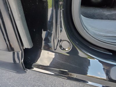

These are the plugs I use in my 2014 "inner rocker panel" to keep goobus out in winter
Almost time to reinstall them
