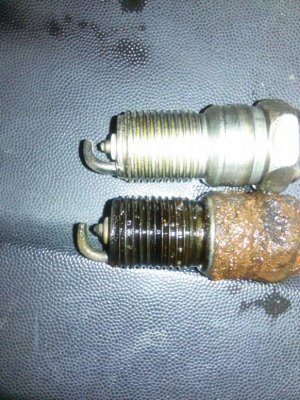

Here's the original next to a new plug. Still looks good to me...

B
bedrck46
sometimes looks are deceiving
Or it could be what you cant see
The insulator could be breaking down in an area that you can't see.
Never assume anything
