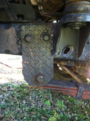

how did you do magic man? i just wanna know where to put the hangers and are f350 lift springs a good choice for the swap? i want a dana 60 in front with the 10.5" rear

I'll get pictures of it all tomorrow. I'm running a 44/8.8 combo. I ran my hangers off the front of the frame rail, you can kind f see in this pic where it all lies in place ImageUploadedByTapatalk1413579543.074558.jpg

Excuse the ****** welds,,,, that was when I was starting to learn I used holes in the frame that were already there, centered my leaf spring pin with the shock and that's where it fell....
