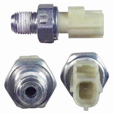

You da man SkyJumper!!!!!! Iwas looking for something waaaaaaay different. I thought it was a silvery bell looking thingy. thanks so much. This is what came up when I googled it. lol
I just read that having the oil filter up behind the bumper instead of where it is in the pics means I have the remote oil filter option. Must be for easier access, but the sensor should be in the same place as your pic. Once again , thanks for your help.

That looks more like a vacuum canister. But the male end of that being beveled and threaded looks as if it screws into the block or piping of some sort.
If you decide to take the sender off, you need to be prepared to have a little patience or alot in some cases and alittle imagination trying to fit a universal wrench or whatever you use to get it off. All you need to do is get it lose and then use your fingers to take it off the rest of the way.
But before you decide to take it off, inspect the pigtail and wire and focus on the length of wire to spot a frayed or cracked or broken wire. If you see nothing wrong with it, then go ahead and inspect the sender once you get it out of there. You can clean the valve end of it with engine cleaner. That sometimes helps, but with it only costing a few bucks, I would just replace it, since you took the time to take it out.
