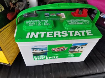

Here are the specs of the battery I bought. She's a bit of a tank, but for the price, I don't think you can beat an Interstate battery.
SRM-27 Marine/RV Deep Cycle
CCA 600
"Marine" CCA 750
Reserve Cap 160
Amp Hrs 88
LxWxH - (12.75"x6.75"x9.5")
50 lbs
