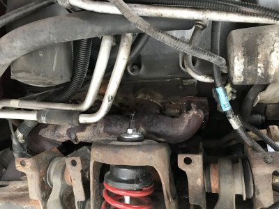

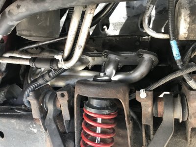

IMG_6574.JPG IMG_7016.JPG IMG_7024.JPG IMG_7026.JPG IMG_7029.JPG I know this is an old thread, but your experience sounds very much like mine.
My passenger side manifold rusted through, and all the studs/nuts were in terrible condition.
I installed a set of eBay stainless headers and a stainless stud/nut kit. It took me about three days to do it. Most of that time was spent dealing with the broken studs and driving to the auto parts store.

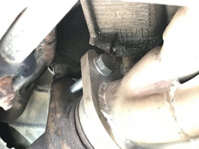

My only fit issue and modification was due to a clearance issue on the right side. The exhaust pipe flange was welded on in a slightly different orientation. This caused a clearance problem between the flange and cylinder head. I used a sawzall to cut a small piece of metal from the back of the cylinder head to make room.
Since I installed the headers, I definitely notice a performance improvement throughout the RPM range. I'm sure my MPG has improved, but I didn't get a baseline MPG to compare against.
