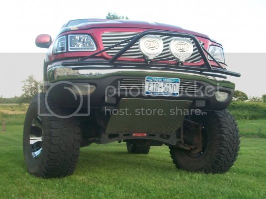

Made mine by myself, didn't make any new holes.... just used a clip from my running boards with two holes already in the crossmember to bolt down low and two holes for the lower valance to thru bolt up top
