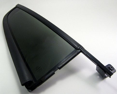

Hey all. I have a 2004 Ford Expedition Eddie Bauer Edition and I have a question about that little tiny piece of glass that is behind the regular glass that goes down. I've included a picture also because I don't know how else to describe it. I circled the piece of glass that I'm talking about in yellow. I'm replacing the regular glass on the rear passenger side, but also need to replace that little piece of glass as well. I've watched a few youtube videos on how to change the main glass, but I can't find online how to do the other one. I'm hoping that I don't have to buy a whole door for it. Any help you guys could give me or point me in the right direction would be greatly appreciated.

If you have the service manual, it's shown in there. If not, download it here: https://spaces.hightail.com/space/hoVVsN5P2A
Rear Door Window Glass —Stationary Removal and Installation
1. Remove the rear door window glass. ( Yes, the one that goes up and down.... )
2. Remove the rear door exterior glass lower moulding.
3. Remove the rear door glass top run.
4. Remove the rear door stationary glass screw. (Interior side under top trim.)
5. Remove the stationary rear door glass.
6. Installation is reverse order.
-Mike

I just replaced this window (a neighbor bought his kid a bb gun !). A few details that will help:
Tip: Inner door panel lifts up and off (4 screws, no snaps - don't pull, lift). Door handle cover unsnaps, window switch lifts up and out.
You can leave the window in, it just needs to be lowered out of the way. The window motor runner must be removed for access. Before starting, lower the window to the bottom (if adjustment is needed later, you can plugin the switch). Remove all of the bolts, remove the speaker for access, remove the 2 window clamp bolts, unplug the electrical connectors, cable holders and the door handle cable, remove the motor, detach the window regulator/motor and lift it through the hole to make room, then lift the window from the 2 clamps and lower the window to the bottom of the door interior.
Remove the bolt that secures the lower stationary glass support. See attachment.
2. Remove the rear door exterior glass lower moulding. The interior facing molding, not the exterior molding.
3. Remove the rear door glass top run molding.
4. Remove the rear door stationary glass screw. (Interior side under top trim. a small gold screw)
5. Remove the stationary rear door glass slowing moving it inward to release the two white plastic clips. Then lift the window out and up until it stops at the angle bracket, then turn it 90 degrees to feed the angle bracket through the window molding .
