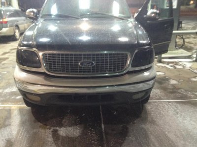

so i jumped the gun and bought smoked headlights for my truck but the light output sucks. does anyone else here have smoked headlights that are bright? i like the look of it but i've been debating on going to clear just so i can see better at night.

Light output will always be diminished with smoked lenses compared to clear lenses with all else being equal. Perhaps go back to clear and lightly smoke the lenses yourself using Nite-Shades or have a shop paint them for you. There will still be a reduction in the light, but it will be minimal if they are smoked lightly (similar to what's found on the 3rd gen Limited headlights).

I like the look just light output is bad. I ordered smoked taillights for the truck as well. is there anyway to get brighter headlights? I have fog lights on the truck and thoses are brighter than the headlights. I'll prob end up going to clear headlights again

You can replace the bulbs with Silverstars which will make them a little brighter. Keep in mind that Silverstars burn out ridiculously fast though and really do only offer a small improvement. Alternately, you can retrofit HIDs.

i have the sylania zxe in the truck now but they wasnt bright at all. i guess my biggest thing is im going for the blacked out look with the truck. i have the silverstars that were in the stock headlight housing so i can swap those back out

If you really want black headlights, then get ones with a black housing, not black lenses.
but i find anything that's not OEM, looks cheesy
i just ordered the OEM type Ford Lighting headlights. Compared to the stock, now yellowish headlights, the visibility should be greatly improved. Will post pics when I receive them.

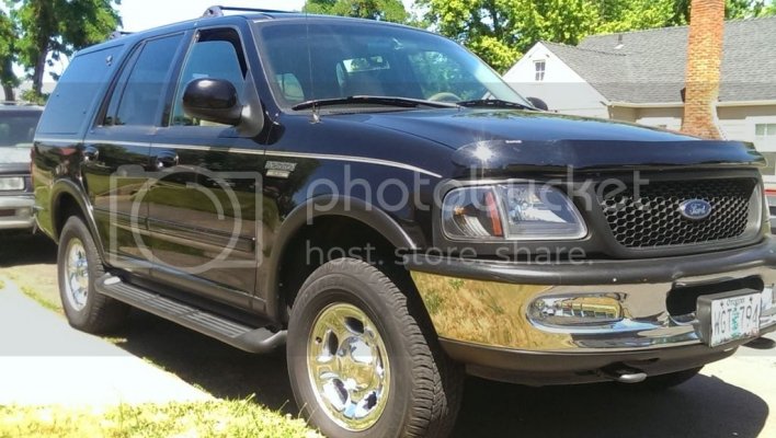

Mine has clear lenses with black backgrounds so they lenses look smoked, but they are actually clear
But as been said, smoke lenses will cut you light output. After all, it is just like putting sunglasses on your headlights.

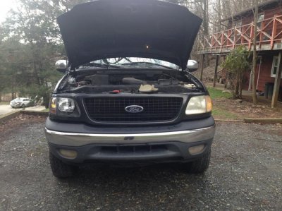

got my new headlights today and i love the look.
