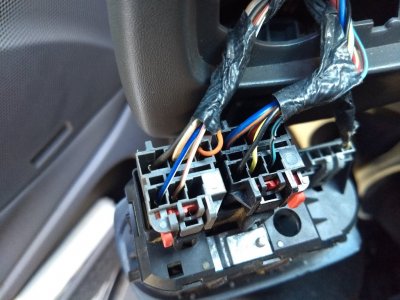

So I've read ALL the wiring mod threads for fog lights with high beams, parking lights ad nauseam and am still having trouble with this one...
Mostly I want to be able to run the fogs with high beams (I have crappy night vision so need all the light I can get) but having them turn on with the parking lights would be cool, too. Having taken apart the switch I'm not going to do the ramp mod so whatever wires I can jump to at least make the fogs work with high beams would be sufficient.
I've tried jumping all the wires that have been mentioned in various threads and tutorials and I just keep blowing the parking light fuse in the power center fuse box.
Any ideas??

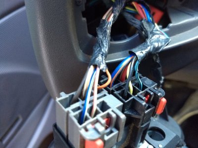

Thanks Maverick! That is certainly a couple options to make this work, and I had previously considered doing something along those lines.
However, after reading so many posts, threads and tutorials on how to make this happen from the switch I was determined to figure this out. Problem was finding info specific to the switched used in this MY, which seems to have only been used a a couple years. The majority of the info is about entirely different switches with a single large plug rather than the 2 smaller main plugs and involving DRLs or auto lamp.
Anyway...
What I had to do was grind and melt out the chunk of plastic that is the ramp in these particular switches, using a dremel and soldering iron, while maintaining the notches. It's not quite as smooth while executing the switching as stock but certainly tolerable. I greased it well in there and may go back in with a small diameter sanding drum to smooth it out a little but it's not a priority. After all this I can get that switch out, taken apart and put back together in about 5 minutes.
As for the wiring I was finally able to ascertain that I needed to jump the dark brown wire in the larger grey connector to the white/black wire(s) in the small grey plug on the far right.
I modified the switch also so I can just leave the switch pulled out in the "fog lights on" position even when the switch is turned off. Another piece of plastic had to be removed because the switch assembly release/removal tabs on the knob create a physical catch so the switch can NOT be left pulled out while in the off position, even with the ramp removed. Weird. So now with the switch left in the pulled out position, I simply turn the switch to parking lights or headlights and the fogs will come on with them. They also stay on with the high beams. This gives the option to still turn them off at any point regardless of the where the switch is set. So this resulted in the full spectrum of lighting options.
I blew quite a few fuses trying to get this figured out so I'm super stoked I was finally make it work by doing the switch mod.
Hope this info helps someone else!
