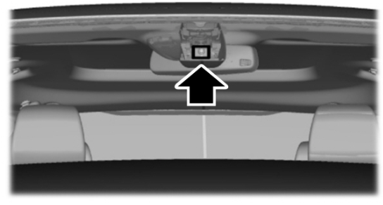

On #3, the lane departure system only functions above 40mph...so if you're below that speed they will remain grey. The sensor is in the rearview mirror housing:
It is blocked or dirty, the guage cluster should give you an alert that the system is unavailable.
Got it, will check it on my way back from work today, if the lights become alive only after 40MPH. Probably the lane divider markers may have to do something with it as well. For some roads lane markers (white/yellow) are painted on, some other have cat-eyes pegged in the roads as dividers. I could be wrong, will check anyways.
Have you recently changed out your windshield? If so, you might have needed to recalibrate the sensors up there. That might help explain the erratic sensor behaviour?
Well no, touch wood - to my info and car service history from the dealership the wind screen is stock factory and not touched. I dread of a time when I have to get it replaced - which usually happens in case of grave damage :)

As far as the lane keeping goes, the lines are grey if the system doesn't "see" the lines on the road. If there is only a center divider line then the right display stays gray and doesn't function until it sees a line and vice versa.

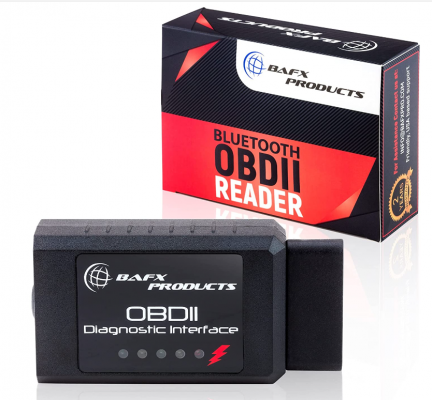

The 2019 XLT’s allowed global windows through Forscan for the front two windows. If you have the one touch up and down windows, then your hardware should be correct. Have you checked the Forscan section of this forum? I believe the 2020’s are different than the 2019’s. You would likely have to enable things on the BCM, drivers door module, and passenger door module.
Thanks for introducing ForScan. I have never used it. I mostly just used Torque for getting the info with my previous car - not making changes to any factory settings.
Can you inform if ForScan needs a particular model/build of OBD adapter or will it work with any run of the mill bluetooth OBDs. I have the following one
Will it allow me to make any changes. As I read in the ForScan forum quickly it always cautious to backup the settings before making changes.
Secondly for any config modification via ForScan - will it void the warranty status or the dealership would have a way of knowing about it upon the next visit.
Any post you can recommend for beginner's intro to ForScan.
