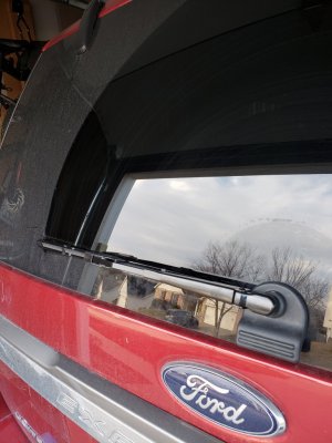

MrSticker, the last two OEM blades I’ve bought have not wiped cleanly. They leave an area mid-span that isn’t cleaned. The one on there now just ripped, and I’m looking for a better option. Also, I can’t get a replacement in a store nearby, the dealer is out of the way. I know I can get them shipped, but I’d like a solution that has future, on the shelf, replacement.
Following the advice in this thread, I ordered a Dorman generic rear wiper arm for my 2017 EL XLT. But, I'm having great difficulty getting the old wiper arm off.
It seems the factory rear wiper arm is aluminum that's press-fit onto to a threaded steel stud. When two dissimilar metals like this get wet while in direct contact with each other, it causes galvanic corrosion. The threaded stud is now corroded as is the 13mm attaching nut. (BTW, the factory used blue thread-locking compound on that attaching nut.)
I was able to remove the nut but the wiper arm won't budge. I don't want to pry too hard as I'm worried about breaking the glass.
I don't have a factory service manual for my 2017, but I do have one for my old 2009 (which I'm guessing is pretty much the same). It says the rear wiper arm should be removed using a "two-legged gear puller." I do have one of these but I haven't used it in years, so of course I have no idea where it is now LOL. That's why I had to take my truck down to a local mechanic to see if he could get the rear wiper arm off for me.
UPDATE: They were able to get the factory rear wiper arm off with a gear puller. I asked them to apply some anti-seize compound to the stud. Hopefully, this will help in case I need to remove it again in the future.
There's an amusing how-to video on this rear wiper wherein it takes the guy 3 hours to get that wiper off.I just soaked mine in rust penetrant, left it overnight and the next day it came off pretty easily.
What they said, I did both. Used some spray let it sit for a few, and then used a small puller. Came right off.I use this puller on wiper arms and stuck battery post terminals. Works very well and I haven't broke it yet. Made in USA too.
Lisle Battery Terminal / Wiper Arm puller on Amazon
