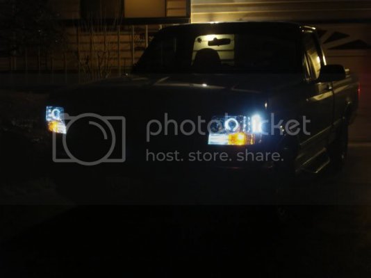

Yeah how do you wire those headlights up? I see the 9007 bulb for the high but what about the 9005 projector?
Most of the time they come with the plug in adapters that plug into your original head light socket and then split to the low/high beam plugs.
If they don't come with them you can order them or you can build your own pretty easily.
You just need to get a socket that fits your original plus the sockets for the other two bulbs. Then find out wich of your original wires is for the low beam and run that to the connector for the low beam and the same for the high beam.
