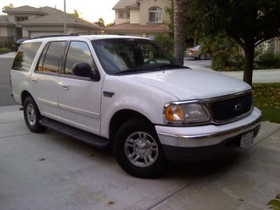

I have a 98 Expedition and the back end is sagging. I can hear the compressor coming on; however it seems to be making a lot of noise and fails to lift the back. It also turns on randomly when I am driving. Please advise...anyone??
