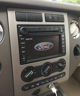

So, I've been told by a few guys its a personal choice, but the 2005 NAV graphics aren't great and the NAV CD is 13 years outdated. I figured I could get the software updated by dealer and buy a used (newer) NAV CD.
Anyway, that's not actually the issue. The issue is that my 2005 wiring harness is not a NAV unit. Actually, none of the plugs will even go in the NAV unit.
So, I need the factory 2005 NAV/Radio/CD wiring harness from a donor vehicle. I've looked in junk yards, eBay, everywhere and it seems to be quite elusive in locating a good (uncut) item.
Any of ya'll possibly have one or know where I could get it?
Any leads greatly appreciated!

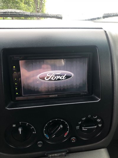

I would go with an aftermarket NAV unit. More modern, faster, easier to install, updates, etc...
Almost any aftermarket double DIN nav unit would be better than a factory unit.

I hear you...but I hate having to buy all that when I have something that would work if I had the right harness. Hard to justify spending $600-700 for a fancy AV unit when I have this one that works (and I still use my phone for NAV, too). If I had that harness I'd still install this one just for kicks.
6,510
3,124
Doesn’t plug in? My 3rd gen came with premium sound but no navigation. I bought a OEM nav/ radio unit from LKQ and it plugged right in and just needed an antenna. Depending if the harness is cheap may be worth it, I liked the factory look that’s why I went this route.

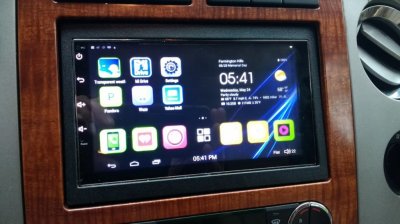

I bought an ATOTO android head unit for $169 on Amazon, includes a backup camera, uses Google maps for navigation, just like having a smartphone in your dash
I have had it for over a year now, works fantastic
man that seems like a hell of a deal. dumb question, does it play just radio stations also. I guess I am old and like to hear local traffic, news, and sports.
