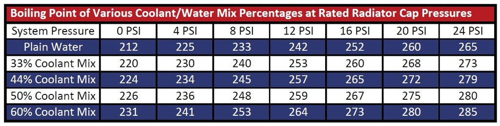

Temp gauge shows up to 240 degrees or more on steep hills on interstate. Shutters had been damaged so were replaced. Problem still exists. Now Ford says this is “normal”. Vehicle never did this until around 60,000 miles.
