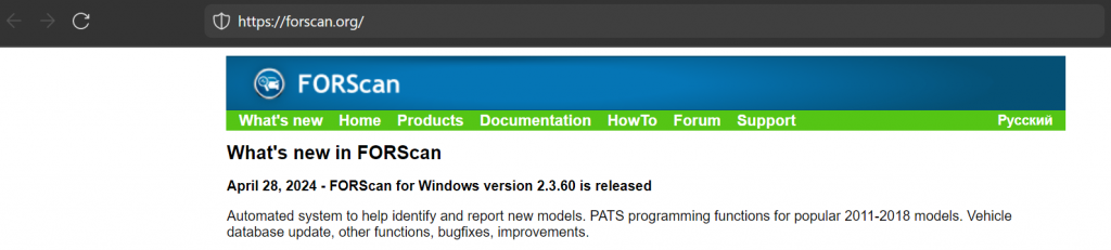

Do you have a laptop and the ForScan app ? You can use ForScan to see if the computer "sees" the key in the ignition. Or to reprogram new keys if need be. Or to read any security codes it might be holding.
ForScan Download Page

Like @Hamfisted said FORScan will be the DIY way forward. The software is free but You do have to buy a connector to go from laptop to vehicles port.

I agree with gettting FORScan. The cable to go from your laptop to the OBD port I s only 40 or $50 online. You will find so many more uses for it down the road then just troubleshooting your Pats system
