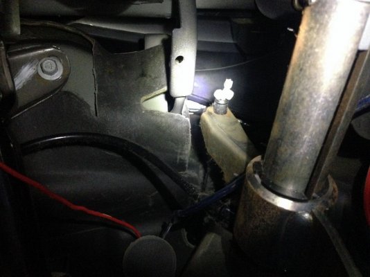

Here are my zip ties. If one were to fail...... it would fall off, end up on the floor mat and I'll go back to having a slacked throttle cable. The throttle return spring is pretty stiff and slams the throttle plate closed. Not at all concerned.
I like fixing things the right way too, but in this case....... zip ties will work just fine for me.

I checked mine out today, although I have about an inch of slack, when the gas pedal is pressed 100%, I do get 100% wide open throttle, so no reason to change or.modify it. My pedal doesn't look like the 1st gen Expedition's either, its all.plastic and hard as hell to just touch the cable, let alone install some.zip ties on it, but don't have to anyways.
