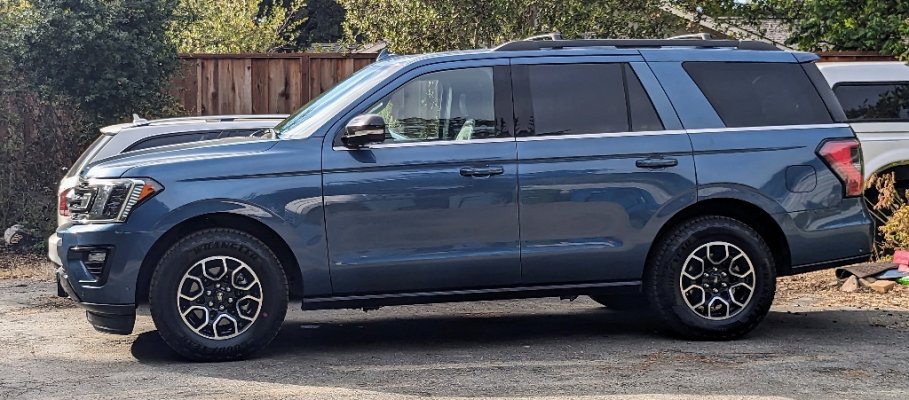

oooh, I like! so 33x12x18's fit without any lift or suspension mods? Hmmmmm.
Right, no lift. The 275/60-20's clear with maybe an inch to spare at most, so with the +18 offset I would be reluctant to go any bigger. I didn't turn the steering wheel when I put my 18's on it, so can't say for sure that they wouldn't rub. But, the tires are Toyo R/T's and they actually only measure about 32" (?). The 275/60's are a hair larger in diameter. So math says they should be ok. If you go this route it will depend on what the true diameter of the tire is.

I did take a picture with a jack under the front simulating a ~1.5" lift when I was going through this exercise. Looks pretty good :)
