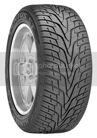

looking to get Hankook Ventus ST...getting a real good deal on them...

I was considering these... how do you like them Freeway?!
LOVE THEM!!! nice quiet and comfortable ride...great handling...stuck to the road good...went to michigan with more snow on the ground then what we get here in VA...did very well...very pleased with them..highly recommend

I checked those out too, I dont think thet come in my size though; 265 70 18. Was recommended dueler at revo2 and bfg rugged terrain today.
