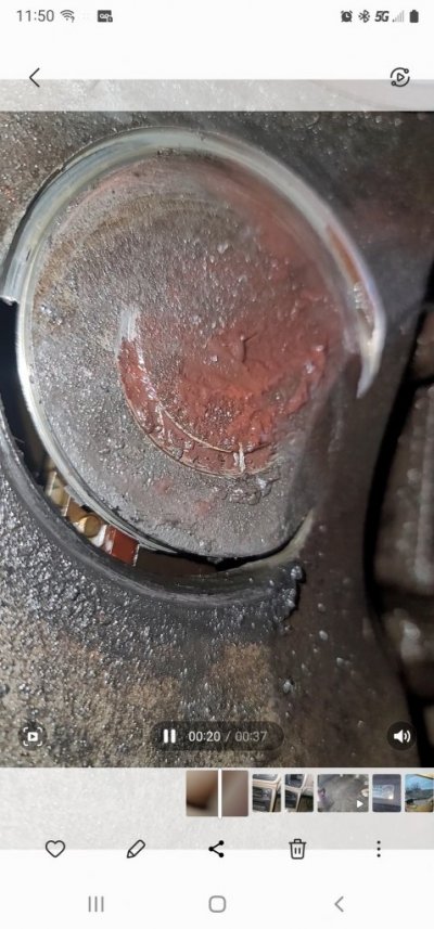

My tensioner pully rubbed a hole in my timing cover and I'm wondering if I can epoxy putty this hole

From the size and shape of the damage. Clean extremely well.
Use a small, thin piece of metal as a patch to epoxy on to the front of the cover.
Good luck and be careful not to get any squeeze out inside the cover.

Absolutely you can. Epoxy it, plasti-weld it, Gorilla tape it...just get it closed to the elements and as stated, keep all "fixing" materials out of the inside...

If you're not going to replace the cover, I would recommend JB Weld Steel Stick instead of common epoxy. You just shape it close to what you need and tap it in flat and let it cure. You can drill it or tap it. It's that strong. You can get it at any Home Depot, or Amazon, or many parts stores carry it. It will be stronger than the surrounding area.
