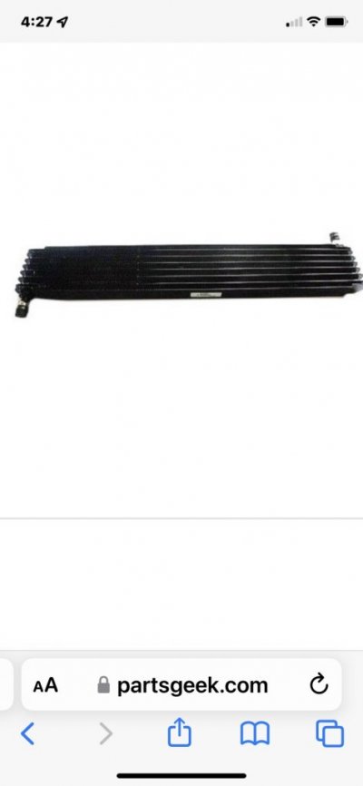

Pop the hood and look to see if you have one of these. Our 2016 XLT had the 4 pin and didn’t have the auxiliary transmission cooler. I replaced the 4 pin with a 7/4 combination and ran a line to provide power to the trailer. I paid to have the transmission cooler installed because I couldn’t find a step by step guide. About $210 for genuine Ford parts.
